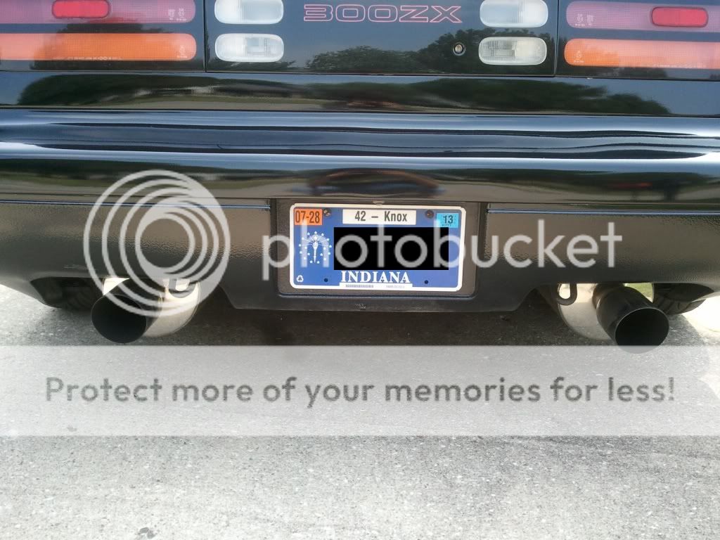

First matter of business was to get some better exhaust I went with Z1 down and midpipes (here in Indiana we don't really have emissions) and Stillen Catback the whole system is 2.5"

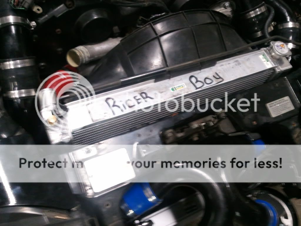

I am a little paranoid about engine heat so I decided to buy the best cooling upgrades I could find to make sure the Z could handle any track day we throw at it with these 100 degree days in Indiana.
The shop I go to is all muscle cars (other than mine) so I always get made fun of... nothing like having ricer on your brand new Howe Radiator, thanks to WingZ for covering it up though!

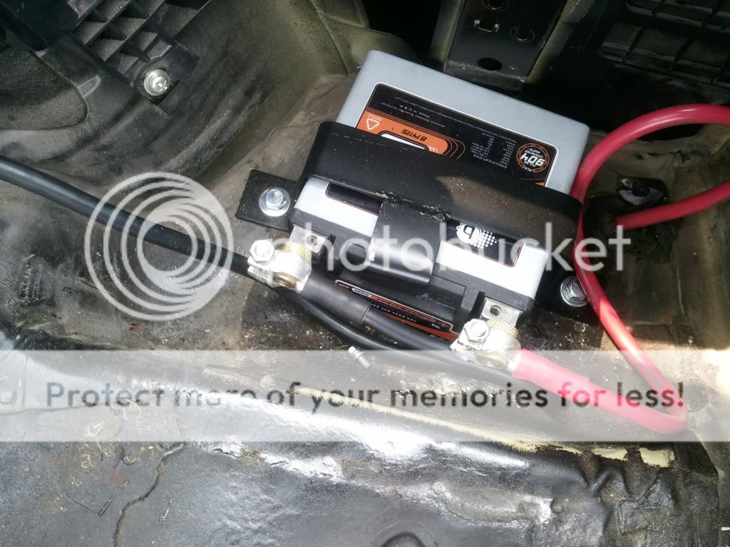

To go with making extra power I wanted to cut weight as well. Thanks to Project LOWFATZ for a guide on how much everything weighs I think we've cut well over 150lbs out of the car with much more to go. One of the things I like the best is my new lightweight battery (It doesn't leak which the last owner of this car could have used letting battery acid drip all down the engine bay). I don't know if any of you guys have tried a braille battery before but it is a 11.5lbs battery and it packs enough punch for daily driving my Z!

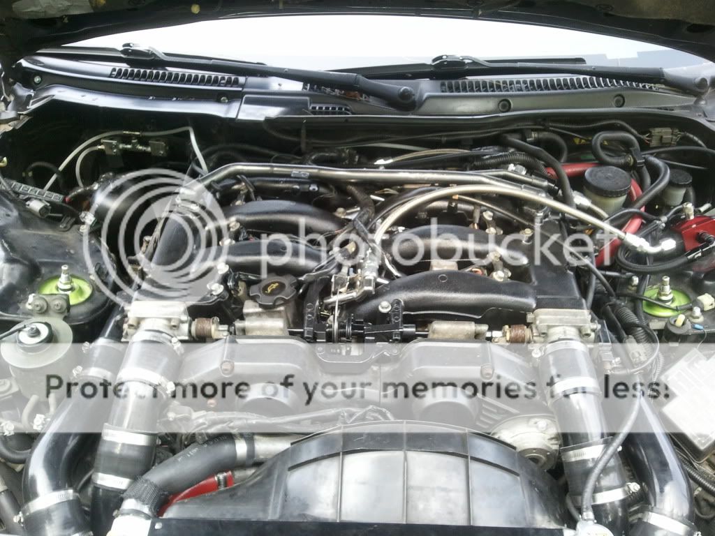

And now for the shot everyone has been waiting for the big cluttered engine bay (man these things are tiny once you start putting aftermarket stuff in there)
The car runs on E85 which is powered by two walbro 255lph fuel pumps connected together with a Y Barb then to a -8an fitting welded onto the sending unit and then I have -8an fuel line running all the way up to the 1000cc top feed injector kit from WinFactory. The car uses the Zemulator for tuning and is currently using a modified E85 tune from WinFactory and running 16lbs of boost on the stock turbos.
